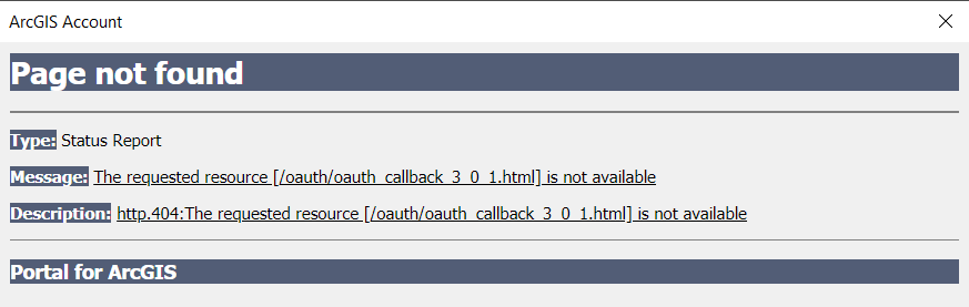

However, logging in from ArcGIS Maps for Adobe Creative Cloud version 3.0.1 or higher to ArcGIS Enterprise 10.9 fails with the following error message:
ArcGIS Account
Page not found
Type: Status Report
Message: The requested resource [/oauth/oauth_callback 3.0.1.html]
Description: http.404:The requested resource [/oauth/oauth_callback_3_0_1.html] is not available
Portal for ArcGIS
Page not found error
This occurs due to a recent update on Adobe apps enforcing a stricter CORS policy which blocks scripts trying to access a frame with a different origin.
