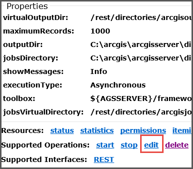

  1. On the Folder - System page, under Services, click PublishingTools (GPServer).
  2. On the Service - PublishingTools (GPServer) page, under Supported Operations, click edit.
Navigate to edit

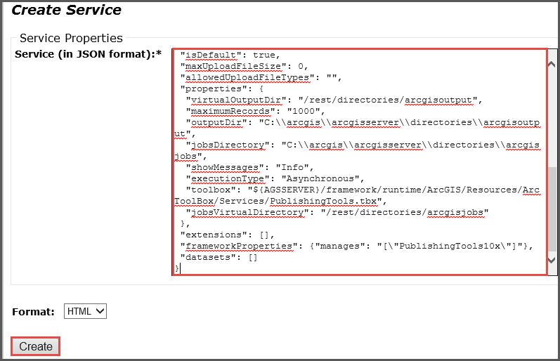

  1. On the Edit GPServer page, in the Service (in JSON format) text box, copy the JSON script and paste it in a text editor, for example, Notepad.
  2. Search for the isDefault parameter. Change the value to false. Click Save.
  3. Return to the Service - PublishingTools (GPServer) page, under Supported Operations, click delete.
  4. Return to the Folder - System page, under Supported Operations, click createService.
  5. On the Create Service page, paste the JSON script copied in Step 5 into the Service (in JSON format) text box. Click Create.
Recreate the service
