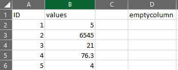

  • Field names are empty.
Image of a CSV file in Excel showing empty columns for field names.

Solution or Workaround
Before uploading the CSV file, ensure that the file is prepared for the following:
  • Each field name is populated.
  • Each field name is not duplicated.
  • Each field name replaces any characters with an underscore ('_') and no commas.
  • Unmerge cells in Excel.
  • Check for string values for for fields intended for dates or numeric (float, integer, double). A cell not aligned to the right would suggest that it is a string value.
  • Use a consistent date format, either as ddmmyy or mmddyy.
  • Save the CSV file as UTF-8 or Unicode in Windows. Open the file in a text editor such as Notepad, click File > Save As, and choose UTF-8 or Unicode from the Encoding drop-down menu shown at the bottom of the Save As dialog box.
  • Location fields should be in a consistent and known spatial reference. Refer to ArcMap: The properties of a spatial reference for more information.
  • Use integer fields are for whole numeric values, for example, '1' or '764'. Or reassign the field type to float or double for decimal values in the CSV, for example, '1.1' or '764.2'. Refer to How To: Change the data type of an existing field for more information.
