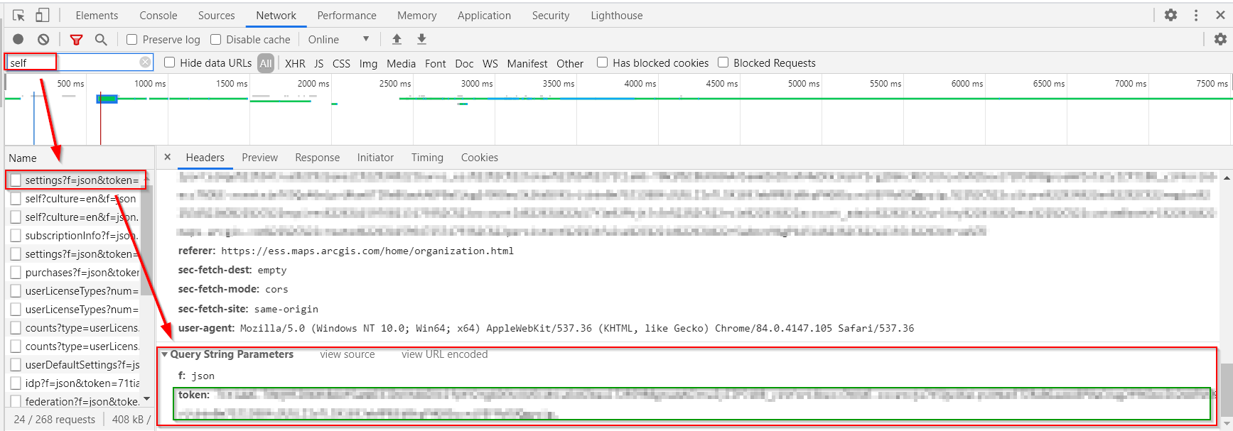

- Open developer tools in your browser. In the Chrome options menu: More tools > Developer tools
- Sign into arcgis.com with your administrator credentials.
- In the developer tools, click the Network tab and type self into the filter box.
- Click the first URL in the Name list, click the Headers tab, and scroll to Query String Parameters (the very last section).
- Copy the token value to use in requests.
