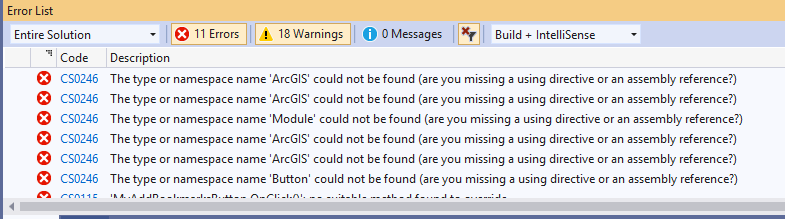

In version 2.5, ArcGIS Pro has changed its Minimum .NET Target from 4.6.1 to 4.8. If code changes are made to an add-in previously created in version 2.0 through 2.4, compiler errors are returned when build is attempted, as shown in the following image:
Compiler errors shown in the Error List

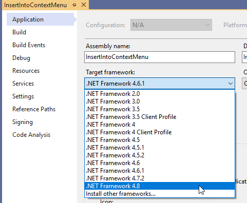

  3. In the Target framework drop-down list, change the selection from .NET Framework 4.6.1 to .NET Framework 4.8.
Selecting .NET Framework 4.8 from the drop-down list of Target framework in the Application tab.

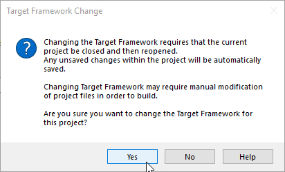

  1. If Visual Studio prompts with a Target Framework Change warning, click Yes.
Clicking Yes at the Target Framework Change warning prompt.

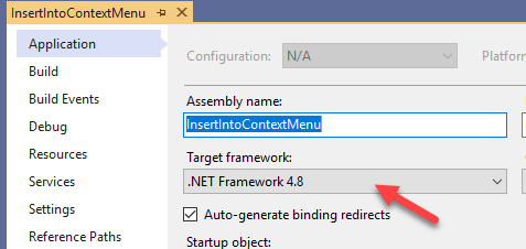

  1. Ensure the Target framework is now set to .NET Framework 4.8.
Checking the Target framework is showing .NET Framework 4.8 in the Application tab.
