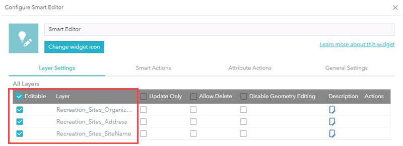

This is expected behavior. The zipped shapefile added using the Add Data widget is not editable. The Smart Editor widget only works with editable layers, which must be set when editing the web app.
As a workaround, publish the shapefiles as hosted feature layers to ArcGIS Online, and recreate the web app.
Note: Ensure the published hosted feature layers are editable. Refer to ArcGIS Online: Manage settings for editing for instructions.
The image below shows the Smart Editor dialog box with the editable layers.
