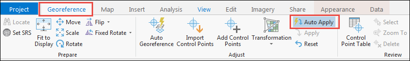

This issue occurs because the Auto Apply option is enabled. By default, when clicking the Georeference icon in the Imagery tab, the Auto Apply option in the Adjust group is enabled. If this option is enabled, the image automatically shifts as the control points are added, removed, or modified. For more information about this option, refer to the following web help page, ArcGIS Pro Help: Adjust.
The Auto Apply option

To resolve this issue, in ArcGIS Pro, disable the Auto Apply option and add all the required control points. After adding the control points, update the display by clicking the Apply option, and click Save.

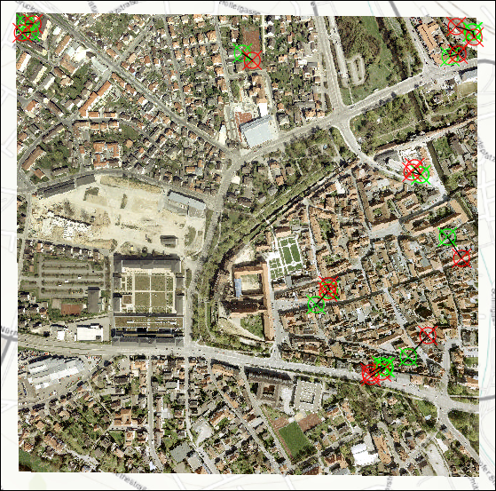

The following image shows the raster image and the control points are displayed on the original location on the map.
The raster image and the control points are displayed on the map
