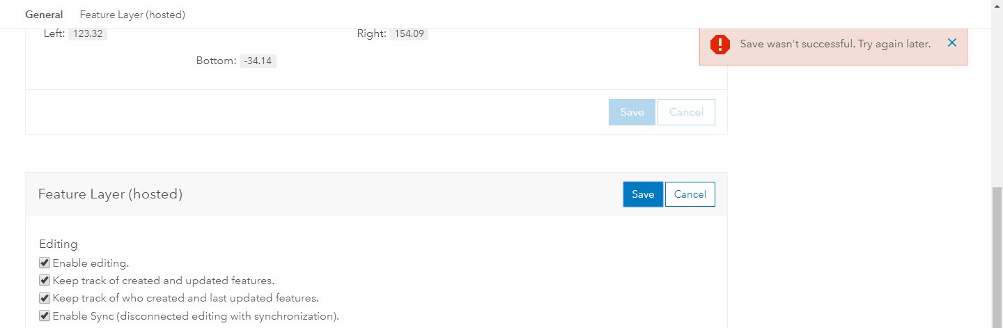

The image below shows the error when saving the changes after editing is enabled.
Screenshot of the item details with the "Save wasn't successful. Try again later" error.
Cause
The hosted feature layer has editor tracking fields attached. Enabling editing causes a conflict because duplicate editor tracking fields are created.

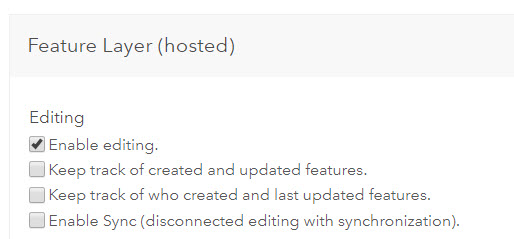

Ensure editor tracking is not enabled when enabling editing on a hosted feature layer with editor tracking fields. On the Settings tab, the following settings must be unchecked before enabling editing and saving:
  • Keep track of created and updated features.
  • Keep track of who created and last updated features.
  • Enable Sync (disconnected editing with synchronization).
Screenshot of Enable editing while the other options are unchecked.
