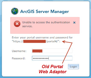

In a federated environment, ArcGIS Server must authenticate through Portal for ArcGIS to verify if users can access the Server Manager. When changes are made to a federated environment, the following error message is returned at the sign-in page:
Error:
Unable to access the authentication service.
Image of the error message when accessing ArcGIS Server Manager

  4. If the Server Manager reaches out to the old web adaptor:
    1. Uninstall the web adaptors and reinstall/configure them to be as they were before any changes were made to the federated environment.
    2. Unfederate and refederate the environment using the new ArcGIS Server web adaptor URLs. To federate an environment, follow the steps in Federate an ArcGIS Server site with your portal.
