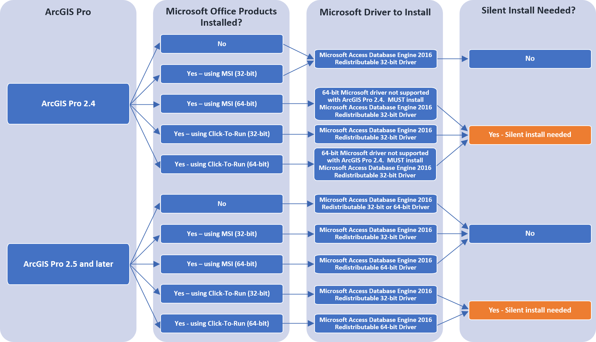

  1. Click the Learn more link in the error message to open the help document: Install the drivers to work with Microsoft Excel files.
  2. Carefully study the Decision Tree Guide in the article to determine the necessary drivers for your environment, this depends on:
    • The version of ArcGIS Pro
    • The version of Microsoft Office on the machine: 32- or 64-bit
    • The method used to install Office, .MSI or Click to run
Note:
Office 2013 and earlier are only .MSI installations.
  1. Install the required driver(s) for the environment in use. This may include:
    • Installing Microsoft Access Database 2016 Redistributable Driver: 32- or 64-bit
    • Installing Microsoft .NET Desktop Runtime Installer 6.0.5 or later: 32- or 64-bit
It may be necessary to restart the machine after driver installation, once done, and the data source is repaired, packaging the project should proceed as expected.
