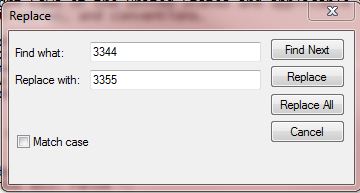

  2. Find and replace all the default port number, 3344, with the port specified in step 1.
The picture of find and replace window

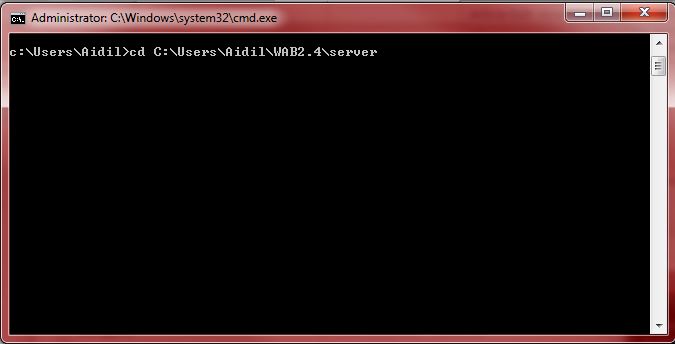

  1. Open the Windows Command Prompt. Windows Start > Search cmd.
  2. Change the directory to the Web AppBuilder for ArcGIS (Developer Edition) server folder.
cd installDIR\server
Picture of changing the directory of Windows Command Prompt to server directory

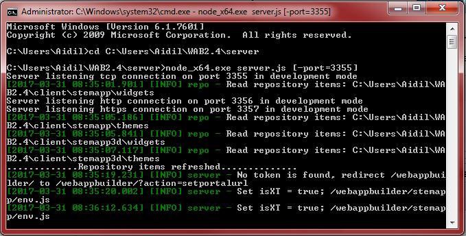

  1. In the new directory (in the Windows Command Prompt), run the new instance the node_x64.exe or node_x86.exe application and adding the new port specified in the previous steps as an additional parameter as shown in the following example.
node_x64.exe server.js [-port=3355]
picture of command prompt window with result
