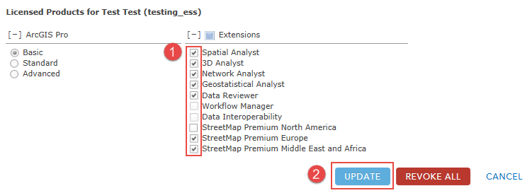

  1. Revoke the expired license by unchecking the affected product that is causing the license to have a negative balance, and click Update.
revoke options in arcgis online
Note:
The REVOKE ALL option removes all product licenses and automatically updates the user with the new license settings.
