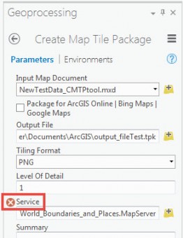

In ArcGIS Pro, when browsing and selecting a valid map service to use for the tiling scheme of the Create Map Tile Package tool output, the Service field displays the red X icon, indicating that the service selected is not valid.
Additionally, when browsing to the folder containing an XML tiling scheme file to add as the service input, the XML file does not appear in the browse window.
