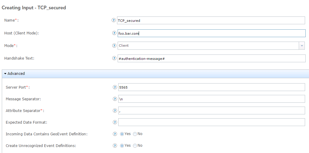

  3. Modify the properties to show: Mode, Host (Client Mode) and Handshake Text properties.
User-added image
This input connector can now be used in CLIENT mode to send the authentication message as Handshake Text to the server to establish a authenticated connection.
User-added image
