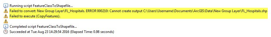

In ArcMap, when a feature class is within a group layer, the Feature Class To Shapefile tool fails to convert the feature class to a shapefile with the following error:
Error:
Failed to convert: [Group_Layer]\[Feature_Class]. ERROR 000210: Cannot create output [File_Path\Group_Layer\Shapefile.shp]
Failed to execute (CopyFeatures).
User-added image
Cause
If a group layer is used as the input feature class, the Feature Class To Shapefile tool fails to create the output shapefile because the folder used to store the shapefile is not created.
By design, the tool appends the group layer name to the file path of the output folder specified by users. As seen in the screenshot of the error message above, the file path of the output shapefile is:
C:\Users\Username\Documents\ArcGIS\Data\New Group Layer
However, the tool fails to detect the file path to store the output shapefile because the path, with the group layer folder added, is not recognized as a valid file path.

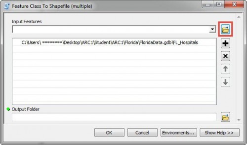

  • In the Feature Class To Shapefile (multiple) dialog, instead of selecting the input feature class from the drop-down list, select the feature class directly from the stored location using the folder icon.
Image of the Feature Class To Shapefile (multiple) dialog box
